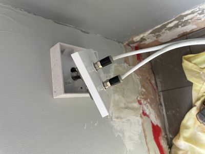

To be blunt, the way that these two coaxial cables are presently terminated resembles an absolute amateur diy bodge.
If you feel capable of terminating coaxial cables with screw on F connectors, I suggest that you cut off the damaged ends of the coaxial cables and then terminate them using screw on F connectors.

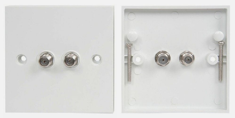

Then I would replace the present faceplate with this design which would hopefully allow the cables to be attached to the replacement faceplate without any tight bends.
If you have any doubts about your ability to terminate these coaxial cables properly then contract this job to a local specialist satellite installer.

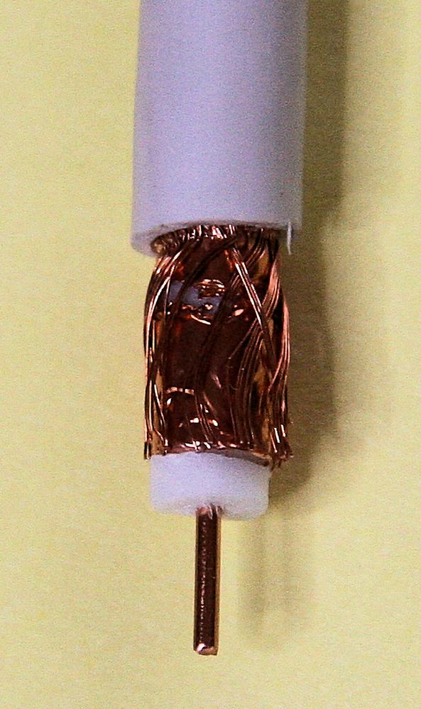

If you are still determined to use your unsuitable wallplate then at least prepare the coaxial cables to resemble this illustration;

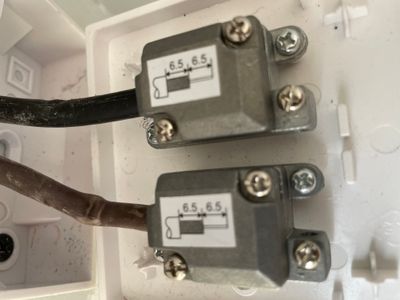

@Draper5   It is impossible to offer advice without at least being able to refer to a clear photograph of the existing cables that are emerging from the dish into the back box, and the ability to see exactly what kind of wall mounted faceplate is being used, as well as how the cables are being terminated onto the rear of that faceplate.
I have to admit that it is the first time that I have ever heard of a Sky trained installer terminating coaxial cables on a wall mounted faceplate, they are specifically instructed to do everything possible to preserve the signal integrity by not introducing any additional joints between the dish LNB and the Sky receiver.

Re: Satellite connectivity
@Godfrey would know better than me, but the connection to the left looks suspect to me, both where the cable has been compressed away from the wallplate, and the connection to the wallplate itself, where the braid and the centre conductor look as though they might be in contact.
I concurr - the left cable as we look at them defintely looks as if the core cable may have snapped & the shielding on both does look very iffy.

Whenever a professionally trained competent engineer installs coaxial cable they will be completely aware that they have to respect the manufacturers minimum bending radius if they are not going to damage that cable during installation.
The minimum bending radius of WF100 / CT100 specification coaxial cables is 10 times the outer diameter, so if this coaxial cable is bent tighter than a radius of around 65.5 mm you can expect to damage this cable.
