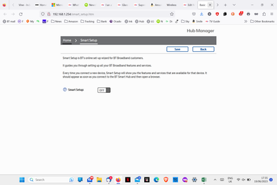

@DaveydeeOnce you have the dashboard open in advanced settings you need to open another tab using the link I gave. I have just tried this from a PC and it worked.
Did you use your admin password to get into advanced settings. Once you are in the hub go into wireless or similar and use your password then the link I gave. I have posted a screen shot, it needs approval before it shows.
