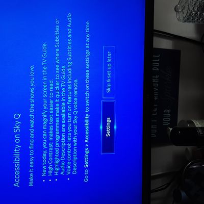

Hi Team
One my mini boxes is not working since problem last week. I have tried everything, even new batteries in remote. I can not getg passed this screen. The only buttons on control to work is. On /Off Sorce Can you please help
Message posted on 25 May 2025 09:03 AM
@Glopurple wrote:
Hi Team
hi @Glopurple
This message seems to have caused a bit of a quirk so try this:
Press & hold 4 & 6 on the remote to set to Infrared only (so must have line of sight of the box)
Hopefully you can then dismiss the message
Then try re-pairing in bluetooth mode with the box by pressing & holding 1 & 3 together
If this does not work try a full remote reset by pressing & holdng 7 & 9 until the red led above the SKY logo button flashes 4 times
Then try the 1&3 to re-pair & pair with the TV

Message posted on 25 May 2025 10:26 AM
Re: QTV Mini Box
Thank you for you reply & help. The instructions you gave worked
All good now 👌
