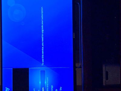

Discussion topic: No connection
Message posted on ‎29 Aug 2024 08:52 PM
No connection
It says , To use this service, you need to upgrade your subscription

OK that's a start @Robert2407
On your photo you are Selecting Apps in the Home menu.
Do you get the Upgrade message on all the options?
Also is this your main Q box or a mini?
Message posted on ‎29 Aug 2024 09:34 PM
Re: No connection
Yes shows up on all the options

Regarding your issue can you get into the Settings Option inthe Home menu
If you can
First check that your viewing card is correctly inserted. Viewing card is in the right hand end of the box.
If it is in correctly there is not enough of it sticking out to grip and remove it.
Push it fully in and it will pop out slightly enough so you can remove it.
Take it out and give the chip a gentle wipe with a damp lint free cloth or E-cloth.
Ensure that it completely dry before you reinsert it chip side up and chip end in first. Push it gently fully in and you should feel a slight click when it is engaged. If it has popped out enough to remove it is not located correctly.
If you are satisfied that it is in correctly
Try refreshing your Viewing card.
Home - Settings - System info.
Highlight Viewing card number and then select Setup on the right hand side.
Then select Use this option to trigger a callback
No call is actually made but the Viewing card should be refreshed.
Message posted on ‎29 Aug 2024 10:19 PM
Re: No connection
It worked . But it is now saying ,To use this service, you need a satellite signal .
