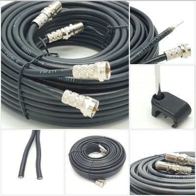

Any satellite coaxial cable extension kit.  Look at the existing cable to see if you need a single or twin version.  WF100 is the better grade, but WF65 may well be sufficient.
81Q8VXRWI0L_f8d3335b-5ada-4dda-966f-df29514d4871_1000x1000.jpg81Q8VXRWI0L_f8d3335b-5ada-4dda-966f-df29514d4871_1000x1000.jpg
