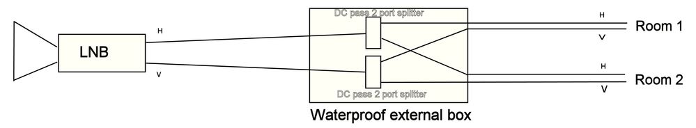

@Liam1029 A suitably qualified independent local satellite installer should be able to supply a waterproof external box which could house two DC pass 2 port splitters, and then run the required twin coaxial cables to your desired locations.
Godfrey.
