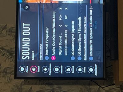

Yes optical/arc

I set to bypass on the tv audio to work for normal and then manually +3 on the delay on the tv for uhd - which is a slightly quicker fix than +20ms on the sky box and +2 on the tv

thanks - these are settings I'm using at min and almost right on most things
HDMI into the tv
then sound out from there is optical/hdmi arc
dtv setting is Dolby digital
av sync adjust I've got +3 on for uhd (sky and Netflix)
and then turn bypass on for it to be in sync for normal hd tv and weirdly Apple TV which is also showing as HDR on the tv top corner when programmes start

Why is optical involved at all here? Sound carried via ARC is an HDMI thing.
Message posted on 26 Jan 2025 09:37 PM
Re: Lip sync issues changing from uhd to hd programmes
that could be the issue should I be using a different setting?

Only use HDMI to connect from the TV's eARC port to the soundbar, if you still have sound sync issues then set the tv's audio settings to passthrough so the soundbar is then processing the audio, not the tv.

so I currently have hdmi from sky to tv and then optical cable from tv to soundbar - which bits need to be where?
Message posted on 27 Jan 2025 12:08 PM
If the Soundbar supports ARC then you should connect a HDMI cable from the TV's ARC socket to the soundbar's ARC socket.
Then other inputs (such as Sky Q) are connected to another (non-ARC) HDMI socket on the TV.
When configured that way the TV will send ('return') audio to the soundbar for any active display - i.e. an inbuilt app, tuner or external input.
That is the 'correct' way to connect it up - but sometimes there are sync issues where you can use a passthrough on the soundbar (if it has one), i.e. HDMI from Q to Soundbar and then Q from Soundbar to TV.
Optical shouldn't be needed at all.

Keep the HDMI connected but disconnect the optical cable..
Message posted on 27 Jan 2025 02:05 PM
And add another hdmi ARC out fron the TV, as per the above
and use passthrough if possible so the TV isn't wasting time decoding the audio
