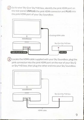

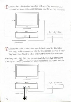

'Sky Soundbox' rather than 'Sky Sound Bar'
The Soundbox manual showed the suggested setup for use with Sky Q like this:
Note that audio from the TV set to the Soundbox is routed over the television optical output: as @nigea99 indicates, Sky didn't see fit to provision the Soundbox for ARC, which may be one reason why it didn't last long as a product.
Scans from this thread provided by @mike+simmonds who probably knows more about the Soundbox than the rest of us put together

Message posted on 09 Aug 2025 08:48 PM
Re: Input switching
Seems to have fixed it, especially as the Sky Engineer had removed the optical cord. Thanks.
