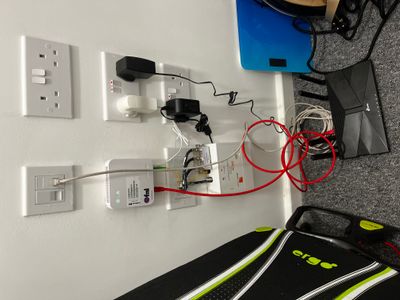

Photographs of the setup would be useful if the forum will let you post them: the rear of the box, the wall socket and the internet router if the property has one.

I shall try to attach a photo! Ok. So it's all fine for internet on other devices.

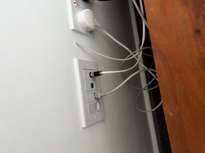

The sky man then attached the cable top left (telephone type) and into the router. He said that socket might not be working and left.

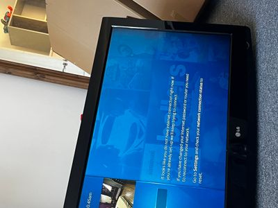

This is what he did at the back of the TV. God knows what the random bit of wire is

I'm getting this message:
