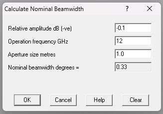

@Padawan The 3 satellites are located in a cluster within around 0.3 degrees of each other.
So, as your test meter is unlikely to be able to measure a signal strength difference less than around 0.1 dB, I have never found it necessary to optimise my dish beam for any particular transponder. I of course always scan across all of the satellite transponders that Sky are using, and expect to easily exceed the minimum required Modulation Error Ratio (MER) quality of around 11 dB on every transponder, with the highest quality transponders achieving around 20 dB.

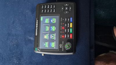

Managed to get use of a labgear 701 meter and am getting readings of approx 90% power (dBm) on both horizontal and vertical transponders with ch noise at approx 80% on horizontal transponders and 100% on vertical transponders. MER is between between 12.5 & 15db. I have taken the measurements again at the point where they plug into the multi switch and the power dips off by 9 - 15%. All is working fine apart from Sky Sports Main Event which is pixelating on fast moving images & graphics....please help as I'm confused.

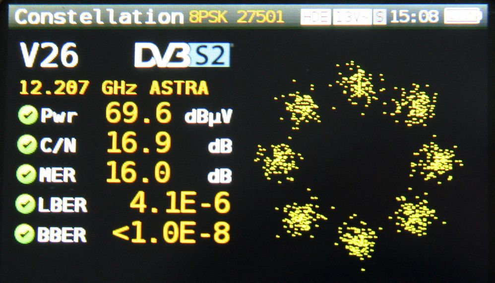

So, if you can select transponder V26, which is used for the UHD version of Sky Sports Main Event
12.207 GHz DVB-S2 8PSK 27500 2/3 Vertical, then take photographs of the results when you measure this transponder signal at one of the multiswitch output ports, it might provide a starting point for analysis of your problem.
As an example this is an image of the constellation quality presently emerging from my personal multiswitch for Tp 26V which is being transmitted via the Europe Wide beam and therefore around 3dB lower received power than transponders being transmitted via the tightly focussed UK beam.
