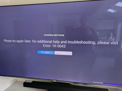

Discovery plus error 1K-0043
I've had this error on my discovery plus app on sky q since the outage a few days ago. I've tried another reset but still getting the error. Can anyone suggest a fix please?

Forgot to say.... it's working on my phone/tablet but not coming on sky Q. Very annoying as I would like to watch on my big telly!
The main menu shows but whatever I press to watch the error appears.
