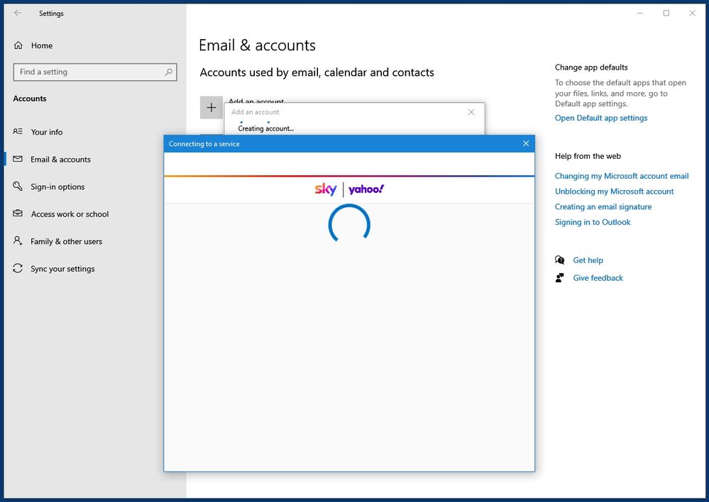

I should mention that it isn't just the Mail app itself which shows this problem.
If I go to the Accounts section on the Windows 10 settings, and go to the Email & accounts option, there is an option there to add an email account, which also fails, exactly the same as if you try to do it from the Mail app.
This is what i'm seeing after putting my user name (email address) into the first setup page from Yahoo.
This stays there permanently and never goes any further.
What it should do is go on to the appropriate Sky/Yahoo page so I can put in my password, but something is causing it to hang. When I set up the Outlook app, it worked fine and the account was set up immediately, so the system obviously can work, and indeed did until I stupidly removed the account!
What I'd like if possible is for someone else with a Sky email address using Windows 10 to also try this, so I can see if they get the same result. As I said, you don't need to use the Mail app, you can just do it in the Windows settings. You can always remove the account again straight away, if it does work!
That will at least tell me if it's an intrinsic problem or something amiss on my setup.
Thanks,
Dave.
→ Wired Ethernet connection to Sky Fibre Max broadband 76Mb/s with ER115 hub.
