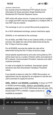

this is what pops up the WBC FTTC is all unavailable the WBC SOGEA the first 2 say available the other 2 are blank i honestly don't have a clue what any of this means
Message posted on 17 Aug 2025 02:49 PM - last edited: 17 Aug 2025 02:50 PM
Re: setting up sky max hub
That confirms it's FTTP, so the wall socket is obsolete.
Could you post just the two lines of text under the table that contains the speed data, starting with 'Our records show...'

Think this is it dunno why the image is being so blurry, Thanks for the help so far!
Message posted on 17 Aug 2025 02:57 PM - last edited: 17 Aug 2025 02:58 PM
'ONT exists with active service'
That means there should already be an optical cable and Openreach terminal unit: unfortunately it's possible that the latter has been removed by the previous occupants.
