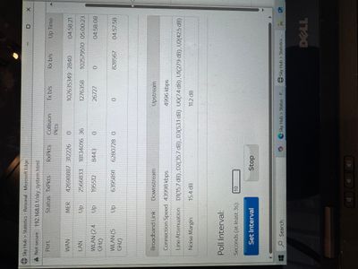

IMG_9694.jpegrouter stats - in the process of removing minis attached via Ethernet and keep to WiFi

@Anna3333 You image is a little hard an blurry to see, but no matter what your NOISE margins are SKY HIGH so you have a faulty line, you need to either run the diagnostic checker to see if you can detect it and get help that way, or call sky and have them run it from there end.

I thought so I get mixed responses on the app line test, most of the time it says it's ok when I'm staring at "no internet" on screen, today is the first time I've got error message on the sky line test, I've got a "TV" engineer coming on Saturday but I've told them it's a broadband engineer or open reach we need... like going round in circles. At least today I feel a little less like I'm the one going mad
