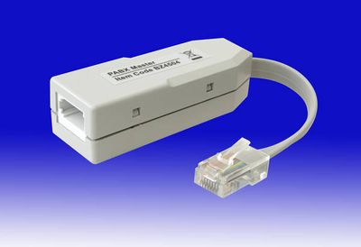

I'd observe that adapters do exist for BT jack socket to RJ45 plug, but these are intended for use in office environments where in-wall 'structured cabling' connects back to on-premises PBX hardware. I've never seen them used satisfactorily in a domestic environment.
