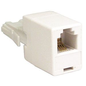

If the phone uses ethernet then that won't work.  If it's actually an RJ11 connector then you'd need an RJ11 to BT plug adapter (or a replacement lead for the phone with RJ11 on one and and a BT jack on the other)

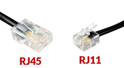

Note that RJ11 for telephony and RJ45 for data are easily confused visually, but RJ11 is physically smaller and plugs/sockets are generally not interchangeable.

An existing dsl rj11 to bt phone jack will suffice
