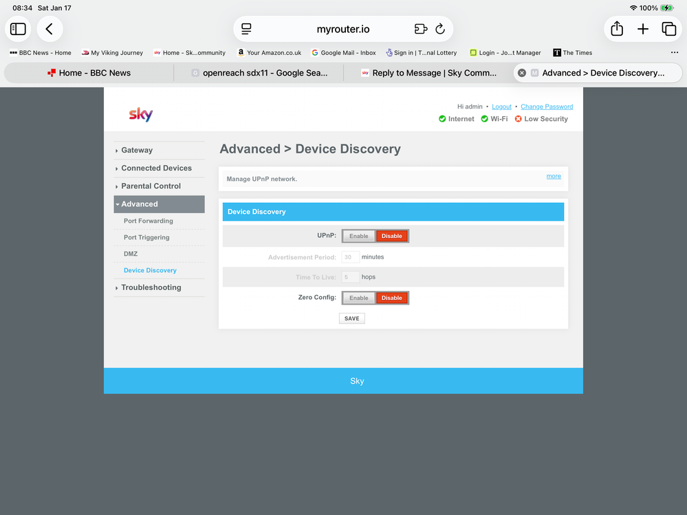

@dex4 first report I have seen of UPnP issues with the SR213. Unlike virtually every other user setting the switch for UPnP is in the hub's web interface as shown below. Can you confirm you pressed save after changing the switch see below?
If you did and the setting was lost in confirms my suspicion that at least some SR213 units returned to the default setting after a recent uodate having answered a post last week about lost port forwarding settings. This should not happen but occasionally some units do reset after a firmware update. This is not unique to this model but should not recur unless you are particularly unfortunate.

Yep everytime it updates ot turns ot off on mine
