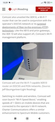

But the XER10 seems to be a Comcast router underneath, as its even got Spanish (Mexican) and on some pages in the code it even says Comcast.
But if anyone can point me in the right direction, ill happily try it agai,n as it is working in Bridge mode, but i would rather just remove the sky router
Message posted on 30 Jul 2025 01:30 PM - last edited: 30 Jul 2025 01:31 PM
Re: XER10 Modem mode
Yes, it is.
