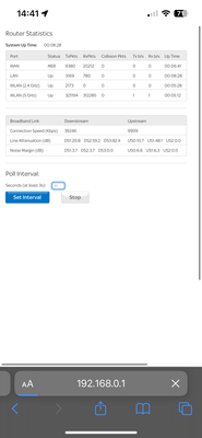

My WiFi connection keeps dropping, been regularly doing it for the last couple of weeks. Twice today in the last couple of hours. Both times today I've had to restart the router and after a few minutes it comes back on.
whenever I do broadband test via the app it finds no faults and tells me everything is good, which it isn't!
any idea what's going on here?!
Avatar for NickCarpo
This message was authored by: NickCarpo
Re: WiFi Dropping
Here are the router stats;
Re: WiFi Dropping
@NickCarpo  Can you please the next time before starting the router login and grab the router stats, but wait 10 seconds for it to populate.

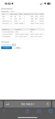

It just dropped again...router stats as follows;
Re: WiFi Dropping
@NickCarpo  Can you run the latter part of the directions if it is showing good on your service check please to see if it finds the fault.

ive run the service checker again and both the broadband and WiFi are coming back green. This isn't unusual - whenever the connection drops if I run the service checker the it always finds no issue.
I should add that usually when the connection drops I don't usually have to reboot the router - after a few mins it normally comes back on its own. Only today I've rebooted the router a couple of times as it's been particularly bad and hasn't reconnected as usual.
im starting to think it's the router that's faulty - it's an ER110 and I thinks it's a few years old now. Sometimes even just moving it causes it to lose WiFi...
Re: WiFi Dropping
@NickCarpo  If you think the router is at fault give Sky a call and let them know about all of the drops and they should be able to see them happening. The ER110 is an older router and is being phased out, so Sky might offer you a new router.

@Highlinder new router on the way 🙂
Turns out the one I have is 7 years old and the technician could see the connection has been very unstable over the past few weeks, so he's sending a replacement.
