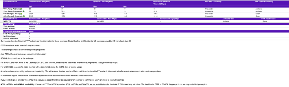

enter your full address in the link below and post the table and notes below after removing your address from the image

Thats an underground feed served by an existing duct and a 1 stage install. Usually meaning fibre is bought from an outside telecoms "manhole" through the duct and feed to the house where an external box (csp) is installed on the outside of the house. Then drilled thru where an internal ont fibre modem will be installed. 1 stage usually means external and internal work is done on the same day and usually takes 12 days from order to install
