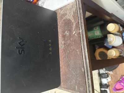

We have full fibre broadband which has worked broadly ok since early August. Recently it has glitched slightly so the number of wi fi bars will dip slightly on the iPhone for example, sometimes the sky hub connection goes and then comes back. This evening it's much more unstable with iPhone (14) dropping to 5G, two bars, 3 bars. Same throughout the flat. According to Sky Q settings on TV, the hub is connected. MySky service checker isn't able to say whether there is an issue with hub connection (it just spins round) and same for devices and setup. I rebooted the router -
but problems persist. Looking at router settings online, bandwidth is set to 20 rather than 20/40 and MhZ is synchronised. The desired channel is set to auto. I've got an older hub (see pic). As you can see it's all green lights on the router. On down detector no issues showing up. MySky does say no local outages etc. Any tips?

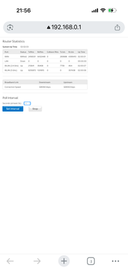

stats from the router website in case it means anything
Message posted on 13 Nov 2025 10:12 PM
Re: Unstable wi fi
@GrahamG76 Looking at them you reset the hub 2 hours ago, you must be on a FF 300Mb/s speed and also connected to a CF CityFibre connection as the Up/Down is displayed as symmetrical. Is that all correct so far. Looks also like you have nothing LAN Ethernet connected, and just using the 2.4/5Ghz wireless only?

That's all correct, yes
