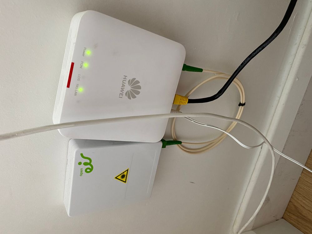

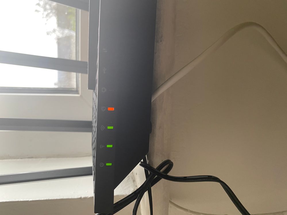

Splashed out an bought a new router, however when I connect it i'm unable to get any internet connection. I'm assuming i need to reconfigure the current setup but i simply just don't know what need to be done.
I've included pcitures of the new router, the red light on Internet and the fiber box on the wall. Any assistance would be much welcomed.
