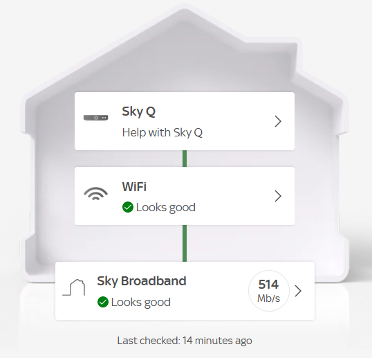

* For the last month or so I'm lucky to get over 250!
* Needless to say, SKY thinks everything is wonderful (see pic below)

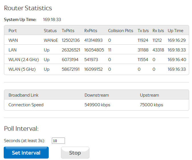

* I've attached my router stats for reference (see 2nd pic below)

What do you have connected via ethernet? You have a few collision packets which in itself isnt a problem but can sometimes suggest there is an underlying issue.

Hi James,
Thanks for the prompt reply. Connected via ethernet are a desktop, a printer, and one SKY box (planning to add the main SKY box and a laptop in the near future).

By coincidence, Sky has just sent me an email saying that I've reached the end of my contract. The email says that the 500Mbps service will continue at £53.00 pcm. A quick search shows a number of other providers offering nearly double that speed for around £40-49 pcm. In fact, Sky's own 900 Mbps package is only £41 for new customers. I've been with Sky for decades (literally, not metaphorically) but I'm beginning to find this all somewhat frustrating. Might there be better service elsewhere?
I'll add an image showing that even Sky's own test recognises the issue now (normally, even when half a dozen third party tests shows speeds in the high 200s/low 300s Sky's test will happily tell me everything is OK and the speed is 500).

@ArnoldStallone to add I have seen similar reports down to 250Mb/s on my own Ultrafast+ connection which I know delivers consistently a full 500Mb/s as I run regular speed tests. I concluded that Sky's speed check is not always accurate which from the reaction from Sky when I raised this with them they agreed with. In theory I could have claimed under the speed guarantee.
