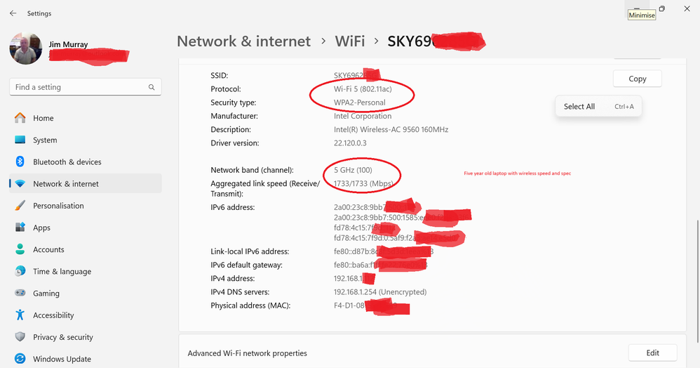

@RaGeViperz Not sure if you have the grasp off speed and control, so here is the sky information linked below. Have you actual got the 5Gb/s + package from sky and using the Latest sky Hub on a CityFibre connection, do you also per chance have at least a 10Gb/s Nic card for Ethernet that you know is working and the PC is capable of the sustained speeds required, or at least close to those speeds.
If your PC is windows based have a look at the Network connected properties and see what it is saying, my pc syncs at 1733/1733 so will atache the picture but you will not see it until cleared for viewing.
https://www.sky.com/help/articles/broadband-speeds-explained
Windows 11 wireless sync speed.

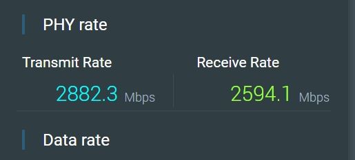

Message posted on 15 Oct 2025 01:58 PM
Re: Slow speeds
@RaGeViperz Internal Network speed sustained combined wired/wireless but does require good Equipment either side. Again once picture is approved for viewing.
Asus XT8 speed throughput
