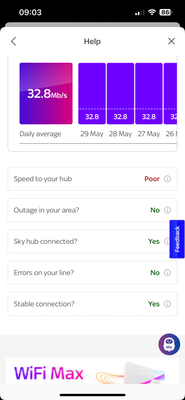

needing some advice as for the past 7 days I'm receiving an error on the service checker for my broadband and when I run the checks I'm being told the internet connection is fixed but the speed is slow and lower than I should be receiving.
any advice on how to resolve this as the home check has came back with no fault to the equipment, I have just upgraded the modem in the past two months.?

thank you for your prompt reply, the tests on the line say I am getting a minimum of 32mpbs which would be the expected speeds for this area so no fault on the line however the actual speed connection to the hub is poor and only providing upload speeds of 9mbs. I've connected with all the cables provided by sky

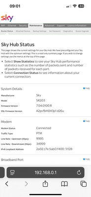

@Davie84 You did not look at the link supplied as what you have sent is not what is needed, you have sent the status page which is basically confirming what sky are seeing on there end, so they expect no issues, unless there is just a software glitch on there side.
So if all seems good for you then just ignore or call sky for them to take a look why it is telling you there is an issue.
The hub stat's if you do post let's the user's on the forum see what is going on direct with the hub, there is a picture on the link so it shows what is required.....

Apologies not great with all this tech stuff. Is this the image which would help ?
Message posted on 30 May 2025 11:35 AM
Re: Slow speed to hub
@Davie84 That's the one, you would be better to call sky and have them run a test against your line, it is showing a higher than normal noise margin which may lead to stability issues and the system lowering your speed to compensate. Hopefully it is not something that is in your home but external to the line.
