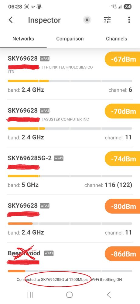

@reelspike Just a couple attached pictures to show you the Netspot display for the signal strength indication, if there is a hidden band it will find it and mark with the word hidden next to it! 5G-2 is my Wireless backhaul AI Mesh speed. So nothing direct connected to it! Tp-Links are powerline!
closer devices
little further away.

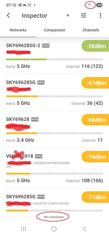

@reelspike Just 2 further to show how bad it gets so quickly, outside back door tripple glazed just hanging in there and no more, and about 20' line off sight to the Router, double brick and tripple glazed window, not a hope in a million years.
It's a no way 20' direct line of sight.
Just about but not very much.
