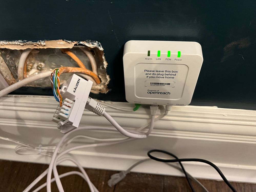

So I got the sky hub working as is.
My setup.
Fiber comes into the house on the west side. I have coax and ethernet running from that point to under the stairs where the networking gear is. From there it fans out around the house to AP's and other Ethernet ports for things like TV and my office. The run is about 4-4.5m from the entry point to network gear.

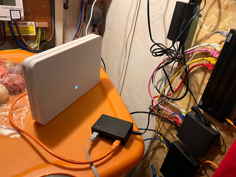

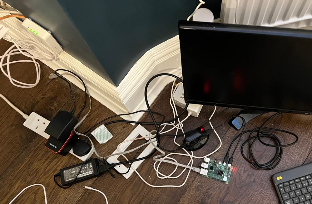

No matter what I did the hub would only run at 100Mbps. The admin would show the ports at 100Mbps. I tried putting the hub under the stairs and plugging the fiber to the ethernet. The hub would then say the ports were running at 1000Mbps but still only getting 100Mbps. I tested the line and it ran fine at 500-600Mbps plugged into a Rasberry PI and access OpenSpeedTest running on MBP Max accessing the network over Wifi.
So to test a theory I bought the cheapest switch on Amz for £6. Plugged that between the hub WAN port and the cabel come from the Fiber access point. Tada, it works now. Apparently it convinced the hub that the ethernet is actually 1000Mbsp.
Bit ugly. Going to let it run over the weekend and see how it does and then make everything tidy. Got some better ethernet ports coming so I'll replace the one by the fiber connection

@Marty+Putney Does not take much to throw the WAN down to the the 100Mb/s connection and data rate, so you do need to know that fact that it is not the Switch keeping the wan up at 1Gb/s nic rate and the ONT down at 100Mb/s. But any speed up near the full wired or wireless returning through the sky Hub will let you know that fact! I was going to do similar but decided NO just keep the WAN direct on a Ethernet single cable Point to Point no patching it through socket's. Did wire all my son's and his 10Gb and 2.5Gb connections are all running fine through the Patched sockets network!
I tried having the box right next to the fiber point but it would only detect 100Mbps when connecting to my network.
