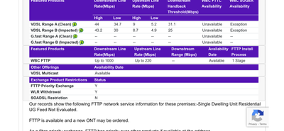

Ordered Sky Full Fibre in early June. Installation date late June (Openreach realised it wasn't an easy connect) pushed back to mid-July (driveway work completed, wires left exposed outside home but no grey box) and now told late August. I'm having trouble understanding info on the screenshot -- I think we're ready for FFTP, but Sky says Openreach say they need council permission? (Our neighbour had FFTP installed within 3 weeks). Grateful for any advice with own experience of full fibre delays or understanding the screenshot info. Thank you

@maka1234 the database says it is a single stage underground install which sounds wrong from your explanation. Suspect the engineers spotted an issue when doing the prep,work which requires a duct to be cleared under the road which requires digging the road up to do that. Openreach require permission from your LA and then they assign a crew to do the work folowed by the final install which takes time.

The relevant bit is 'UG Feed Not Evaluated' but if there's an optical cable now in place all the way then that's been superceded.
