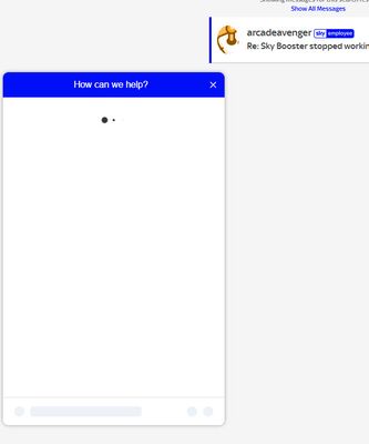

The Sky Expert suggested I change my Gateway address. So I did. But now their messages won't display, so I can't talk to him anymore !!!!

Hi @AntOnSky I have sent you another invite to chat to continue.
