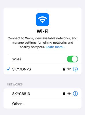

when I first got my sky tv and broadband package, an engineer installed a booster to get my wifi to a mini box at the opposite end of the house to my router and main box.
I have since switched to Virgin and the booster was only used to boost the main box signal to the mini. I think the booster the had its own ID when it hadn't previously.
im back with Sky Broadband now and it seems like the booster is still creating its own ID when I want it to be the 'mesh' it was when first installed. I've tried resetting and reconnecting to router but keeps creating the additional network.
any help much appreciated.
