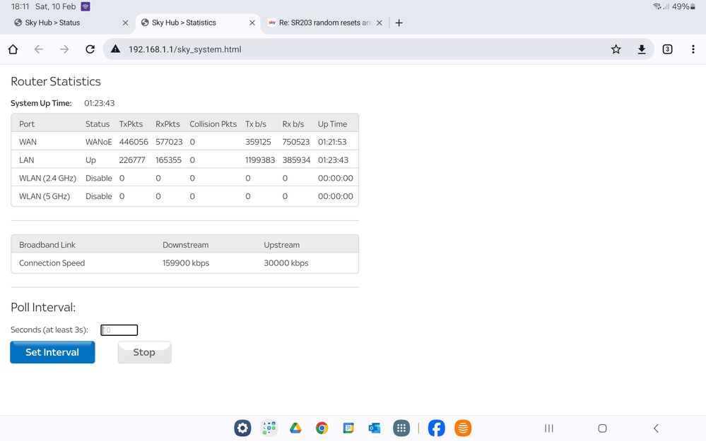

Hi, so I have the sky router, wifi now turned off, tp link EAP670 access point connected via ethernet. TP Link switch with Hive, Ikea hub, printer, Netgear network drive and samsung tv all connected via switch. All other devices connected via access point on wifi. two SSIDs one for computers etc one for all IoT type devices.
ONT lights always green. When internet drops as soon as I can get to router always see red power light. logs always show time resets too. Been in house 9 months, fibre to property, house built 2019. No obvious device additions relating to reboots. I assume it would have to be a ethernet device that 'may' cause router to reboot ???
Had ups connected but deleted currently. Netgear NAS hard drive connected to same AC source and this never reboots or shows power loss.
Logas always show time loss and WAN and LAN up times as reset also.

Message posted on 10 Feb 2024 06:14 PM
Re: SR203 random resets and lots of UNKNOWN devices
This is after recent reboot
