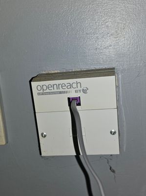

@jamesn123 it plugs into a white thing on a wall but there's 2 sockets, and long thin 1 and a small square 1 it plugs into the top small square 1. And how would I find the details to manual set up?

Does it look like this?

Re: Router
@jamesn123 it looks like this

@Esiwbob
Okay so your on FTTC.
For FTTC you need a router with a modem built in or a seperate modem to plug into. It looks like the Tenda AC8 doesnt have a modem built in so you'd need one before you could connect.

Re: Router
@Esiwbob
So then it's FTTC broadband, and a non-Sky router cannot just plug in and work.
