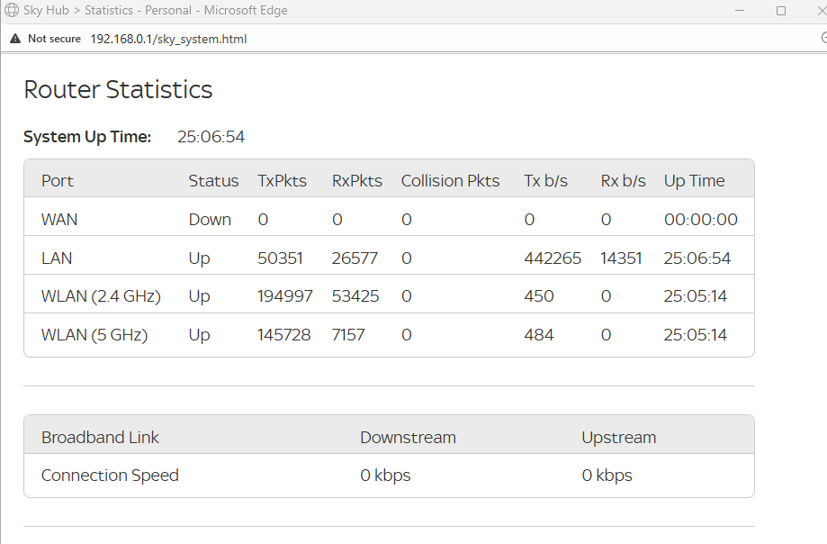

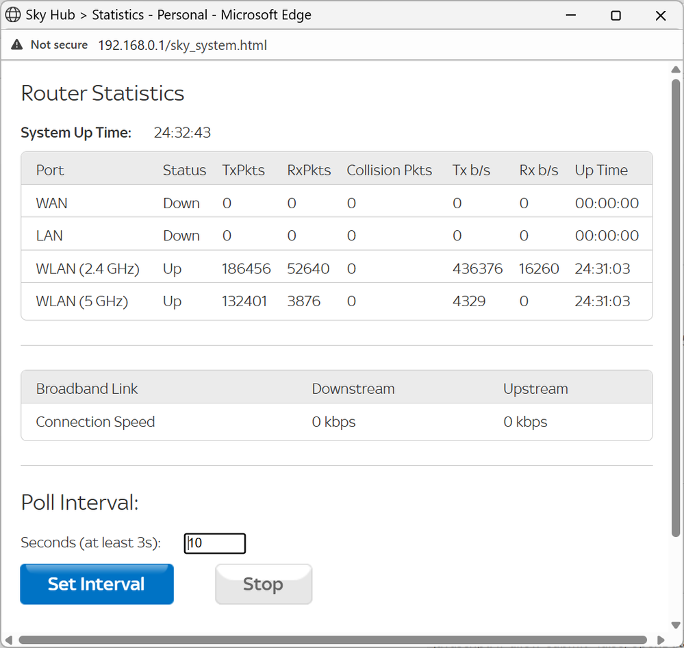

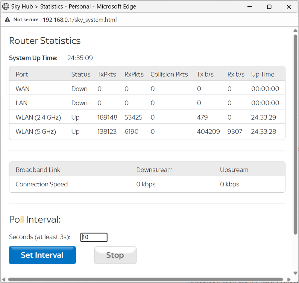

@sgb27 SR203 Stat's below once cleared for viewing.
2.4Ghz band2.4Ghz band5Ghz band5Ghz band
