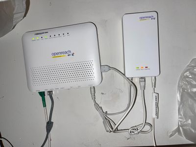

I have a red fault light on the OCN?

@JimM1 the nature of the red fault is dependent on the ont
To find the true fault the customer would need to open the housing.
On older ont models the "fault" may be down to a back up battery loosing its charge
@Suzy15 could you post a photo of the ont

@JimM1 customer may be referring to this
Hard to say at the minute
