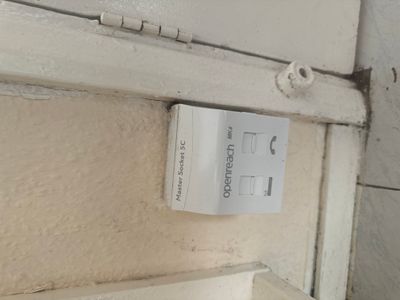

Message posted on 23 Oct 2024 02:54 PM
Re: Problem my cable purple
A wall socket cannot carry a 500Mbs Ultrafast broadband service: only optical fibre and an ONT can do so.

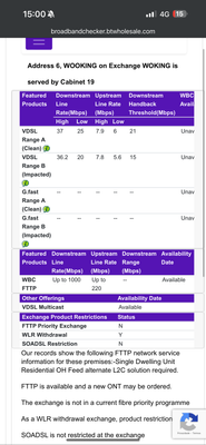

Could you enter you full address into the checker below and copy and paste the notes below the table
Message posted on 23 Oct 2024 03:00 PM
Message posted on 23 Oct 2024 03:05 PM
That confirms full fibre fttp
If you haven't rec'd an ethernet cable conversion kit go to currys etc and ask for a category 5e ethernet rj45 to rj45 cable

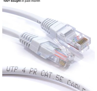

I received cables similar to these
Message posted on 23 Oct 2024 03:19 PM
Yep. Thats the ethernet cable. But what about the ont i posted above that should be installed on activation day. Have they been yet?
Message posted on 23 Oct 2024 03:22 PM - last edited: 23 Oct 2024 03:30 PM
@Camyllaataide @cookiemonsteruk
'OH Feed alternate L2C solution required' probably indicates additional installation resources are going to be needed (perhaps a cherry picker or more specialist ladder team) and that can lead to delays.
@Camyllaataide nothing you can connect to that wall socket will provide a broadband service: you're waiting for FTTP.
