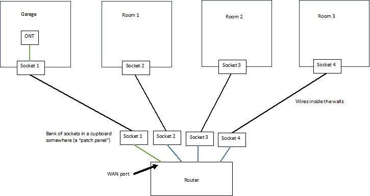

Message posted on 26 Aug 2025 07:41 PM - last edited: 26 Aug 2025 07:42 PM
Re: Possible to connect to Hub through wall ethernet?
@Arvandor593 wrote:
Do they expect me to have half a dozen separate routers running?
A Sky Hub has four ethernet ports, so with one used for the ONT can support three wall sockets. Adding one or more ethernet switches (not routers) can expand this number to more than any household needs.
This is where the topology I mentioned above comes into play.

Message posted on 26 Aug 2025 10:01 PM - last edited: 26 Aug 2025 10:12 PM
Something like this:
You can then put a separate wireless access point in the living room if you want.
