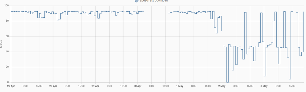

I've got the same problem and am trying to work out if the issues are from inside my network or a sky issue.
I use Unifi equipment and am seeing really bad packet loss ~65% and very high latency, poor speed test results but all from equipment inside the Unifi network. So trying to narrow things down before blaming Sky, at the moment there site is saying everything is fine with my network and equipment.
