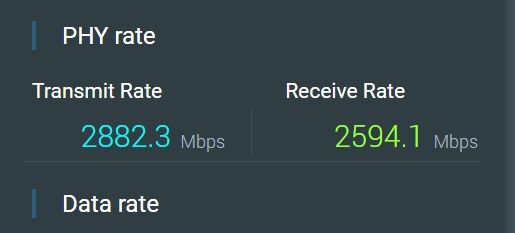

@HercDotMe Asus and as wi-fi 6 what you get so no idea what the latest would be up at.
Asus XT8 Router speed'sAsus XT8 Router speed's

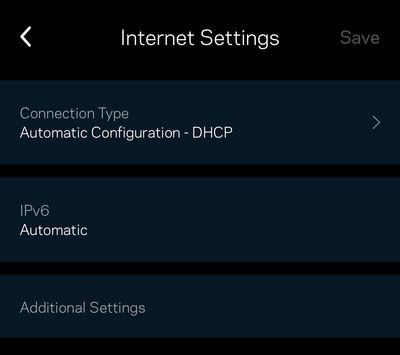

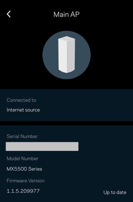

Here's the info including model and make of the router and settings page.
I am using a Linksys Mesh system, these are the settings required on your gateway node. Essentially, it's all default DHCP.

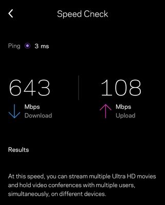

The speed reported by the router is a bit lower as there's a few streams and downloads going on but if I stop everything and connect the cable into my laptop I get around 920 Mbps down and 98 Mbps up.
Hope this helps fellow users.

Since I cannot edit my reply, the router is a Linksys MX5500. You only need to do the internet settings on the mesh node connected to the OpenReach box, the others are full default settings bar for the naming if you care for that.
Hope this helps the search engines index this thread.
