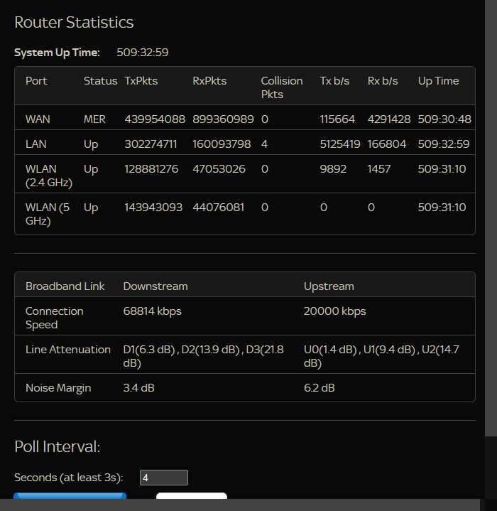

Here's my router statistics:

@Suzie10 it maybe worth rebooting your Sky hub as it has been running for 3 weeks but honestly there doesnt seem anything wrong with your line from the stats you have posted. If the game is run peer-to-peer you are relying on other players connections so if someone has lousy wifi or a dodgy line could that be the issue?

Looking at the router stats the broadband line is a short one with quite a bit of cross-talk, eg: about 160 metres to the cabinet, so I'd expect a maximum speed of 80/20Mbps which it isn't achieving with that cross-talk and slight noise it will impact performance and latency. When the broadband line is loaded and because the noise margin is 3.4dB and only achieves just under 69Mbps downstream it is a poor cooper pair that there is likely little you can do about until full-fibre becomes available, unfortunately.
