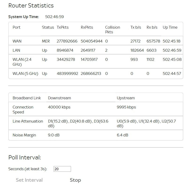

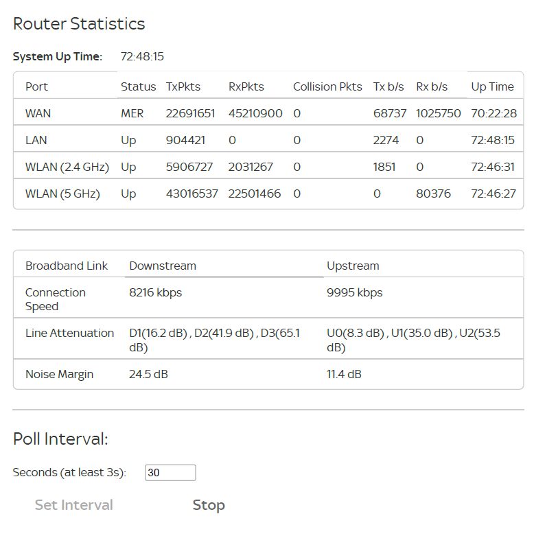

Re: Ongoing WAN/DSL drops - repeated DSL sync loss
@callyy It's all up to you, will go find another older stat's link from when i was on the fttc connection, think i have both a good and a faulty one so will attach for you to see, on my other laptop just got to go find. You have probably a cable connection disturbed in a ground box, it happens and with that noise margin wan drops will occur until the cable joint get's fixed! Pictures you will see when they get cleared for viewing!
Good running SR203 idealish values!Good running SR203 idealish values!Hanging in there SR203 so lived with!Hanging in there SR203 so lived with!
Bad running SR203 very High Noise margins, bad external cable connection!Bad running SR203 very High Noise margins, bad external cable connection!
