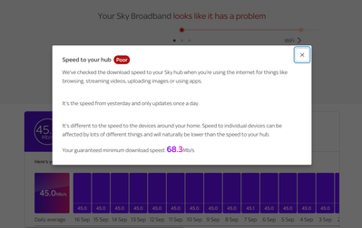

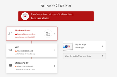

Hi all,
I’m consistently getting ~45 Mb download on my current Sky broadband, but my guaranteed minimum is 68.3 Mb. I have a fibre upgrade booked, but the install date keeps moving (originally June → July → now 30 October). I work from home, and the current speeds are having a real impact, so I’m looking for help to get my existing service closer to the guaranteed speed while I wait for fibre.

Router stats (wired, test socket):
- Sync 49,398/19,000 Kbps; SNRM 6.4/10.1 dB; Attenuation D1 9.8 / D2 15.2 / D3 21.7 dB; DSL uptime 814h+.
- No resyncs seen; logs show only hourly DHCP renewals and IPv6 events.
- Expected IP Profile (down): ~47.8 Mb (sync × 0.967). My wired speed tests are ~45 Mb, consistent with that.
I’ve done a full isolation test at the master test socket with microfilter, only the Sky Hub connected, single device by Ethernet (Wi-Fi off). After a reboot and 5 minutes to settle, the stats were unchanged, unfortunately. To confirm, when I first got Sky over a year ago, speeds were consistent and far above the guaranteed speeds. One day it just seem to drop and never return.

Hi @ceryni
I suspect what has happened is that your FTTC connection wasnt great to begin with but was healthy enough to run at the lower SNR of 3.0. However something changed or a line fault developed which has jumped the SNR back to default 6 and unless line conditions get much better DLM will never step it back down as it favours stability over speed.
In terms of getting this looked at, if you already have an order in progress with Sky they very likely wont/wont be able to organise an Openreach visit for you. The options would be to cancel your order, then get the fault looked at, or just hold out for your FTTP install.
Openreach seem to be basically binning off dodgy copper lines if FTTP is available in the area or is going to be installed soon so they probably dont really want to investigate it either.
