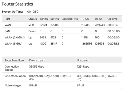

@Hards05 Could you please post your router stats following the link below.
Message posted on 12 Apr 2024 05:36 PM
Re: No connection or extremely slow speed
Message posted on 12 Apr 2024 07:14 PM
@Hards05 How long have you been with Sky and when joining what speed did they quote you should get. As your upload speed is far greater than your download speed and this is something that should never happen.

Update: Had Openreach engineer round who did his stuff but whilst the connection is stable and connecting isn't an issue, I still have extremely slow speeds.
The weird part is that the Sky Hub diagnostics show a much better download speed as shown below yet when I perform an online speed test it is still sitting at around 1-2mbps
Message posted on 15 Apr 2024 05:05 PM
@Hards05 @How are you doing the speed test? If you are doing it on a device using WiFi it can be unreliable. Any number of factors can degrade a WiFi signal.
Ideally you should test using a device connected to the hub via Ethernet to get a more accurate reading.
