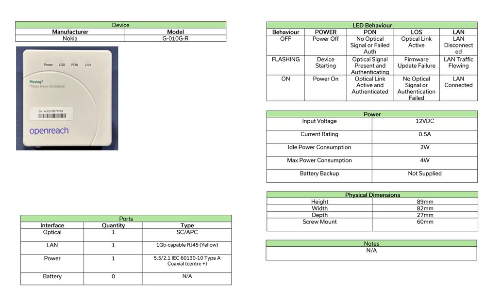

i think you may be right, I've never heard of an ONT but I think it is the Nokia one at the bottom of this page https://internetservices.freshdesk.com/support/solutions/articles/5000842772-fttp-openreach-ont
Does the sky router just plug into this then?
I have also checked and no we don't have city fibre in this area. Just open reach, virgin and hyperoptic fibre to the property
Yes, or the router from any other ISP using the Openreach optical network.
Message posted on 15 Nov 2025 09:48 PM - last edited: 15 Nov 2025 09:50 PM
Re: New build installation query
@AT2021 This is the latest Nokia's that OR are using, yes sky hub port4 wan connection to the ONT lan port there is only one on the latest!
Get yourself a longer Ethernet cable to stick the sky Hub where you need it. Picture will be enabled to view once it is checked and approved!
The Nokia ONT from OR Openreach!
