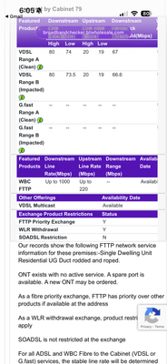

If it's in the UK, putting the address into the BT Wholesale Availability Checker should indicate which broadband provisioning type is applicable.

No idea what any of it means
if you need anymore information please let me know

"UG Duct rodded and roped"
So an Openreach optical fibre is going to be installed through an existing duct which is known to be clear of obstacles and contains a draw cord.
That gets the connection as far as the bottom of an external wall, from where it will go through a newly drilled hole to inside the property.

Oh, hang on.
"ONT exists with no active service"
That's why you were initially told you don't have to be in.
Is there any sign of either an Openreach ONT or a space where one might have been?
