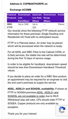

I also wanted to add this. I have an Openreach box installed at home, and I was told that once I purchase an internet package, it will be activated. When I enter my postcode on the Openreach website, this is the screen that appears. I hope this helps.
Message posted on 22 Apr 2026 04:00 PM - last edited: 22 Apr 2026 04:11 PM
Re: New Build Property – No Broadband Showing for Postcode (Openreach Connected)
That's a statement of intent rather than confirmation of actual availablity.
Unfortunately the presence of hardware (including an ONT) doesn't itself get you broadband because without the necessary database entry there's nothing for an ISP to use in processing their order for wholesale provision of a live circuit.

In my latest check, this is what appears for my address. Could you please take a look?
Message posted on 22 Apr 2026 05:37 PM
I'd think the second paragraph is the significant one.
