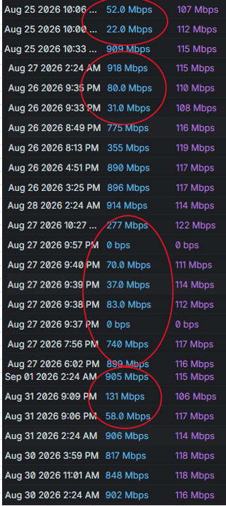

Hi all. I think I already know what the issue is, and I'm sure you all do to. In August 2026 we moved from Starlink to Sky Ultrafast FTTP. The move was due to the NBI finally connecting our home. I thought I give the 1gig plan a go, but dont really require it. Only three of us in the house and we don't game. I have my own Ubiquiti gear and set that up and disconnected the sky hub after about day 3. I haven't really been paying attention to speeds, but almost every time I did a speed test directly from my router I was getting about 900-950 down and pretty much 110 up. I did notice on my ubiquiti dashboard that the latency would be consistant all day at about 6-7ms, then like clockwork from around 8-11 that might jump to 40-50ms. If I run a speed test during these times I can get anywhere from 30M - 50M - 200M speeds. I reconnected the Sky hub and don't mind the double NAT. Over the past week or so the results are the same. Extremely slow speeds at peak times, every day from 8-11pm. There is no other reason for this only congestion as I have done test with only one laptop WIRED to hub and everything else disconnected, no wireless clients. How can I have a 1gig connection that goes below 100M ..? Crazy. I have contacted sky and an engineer is due to call on Wednesday next. He may spot something, but I doubt it. This was happening with my ubiquiti hub, and also with SKY's own hub so we can rule hardware out. I know FTTP connections are split and there is a contention of about 30-1 but we all can't be hogging at exactly the same time? I wonder is the split much higher that 30-1. Anyway, I have signed up to Sky broadband for 1 year, however if this continues I will try to get comreg involved as this is Appaling? 1gig fibre getting sub 100M....poor. I don't think I ever saw Starlink drop below 200Meg and I know Sky is cheaper but seriously...???

Every users situation is unique so there's no particular answer to that. What you will have is a minimum 600Mbps(?) on a 900Mbps connection. Your uploads are very consistent which is good, what is it that you're using to measure DL speeds (app and device)? It would help by the way if that table was sorted by date & time to see if there's a pattern there.

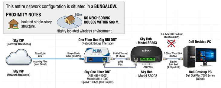

So today and this evening I disconnected everything from the Sky Hub. The topology is as follows..
The speed test during the day using this configuration were perfect. About 900-950 down and 112 up....consistantly. Then this evening after 8 pm I ran some speed tests and the results were again poor. Some sub 100M sone just about 100M. Please bear in mind I only have one P.C. connected (wired) to the Sky hub during this testing. I also have the Sky hub wireless radios off. See results below..
These are results from earlier in the day with the exact same network topology.
As you can see, very little deviation.
This has to be external network congestion right?

@Tony012334 I don't think that's local congestion, it's more likely a bottleneck either where the NBI hand over the stream to Sky, or perhaps at the exchange end where Sky's backhaul capacity at the local exchange before it enters the national data stream.
Perhaps NBI got overly ambitious laying fibre and then dumping too much into the Sky infrastructure all at once?
You need to convince the engineer (and you've got excellent evidence there I think) to log it as an upstream capacity/backhaul fault so it can be escalated to Sky’s network team for further investigation.

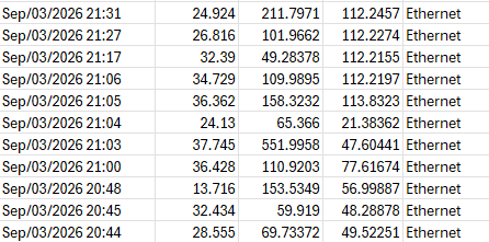

So the sky engineer has come out. He was more of a wifi engineer and found no issues. This has been reported back to Sky. I have subsequently been in touch with a customer support agent in Dublin. The have forwarded my complaing to the MBI team. The NBI team have sent a guy out yesterday to check my fiber connection and it all probes out fine. I have explained to all of these people hat the issues in only occuring between the ours of 8-ish to 11-ish pm. SKY have been extremely helpful in this matter but it does appear to me, and eveyone else who has called to check this problem, that is is indeed an ISP related issue. Most likely a bottleneck in the system somewhere. I will post any updates as I am sure Im not alone in this issue. Thanks for the feedback.

@Tony012334 NBI are reported to be using a GPON set up where your connection will be sharing a connection with up to 31 other lines connected to a passive distribution point. While I cannot find any data on the exact setup they use but Openreach in the UK who also use GPON have a shared 2.48Gb/s downstream link. Statistically very few users ever use the bandwidth they buy but we do see reports of 900Mb/s connections going below the 600Mb/s minmum at peak times. Openreach sell connections up to 1.6Gb/s so pretty obviously if you are on a distribution point with a couple of very heavy users there is less bandwidth for the other 30 customers. I would think that more likely than congestion issues in Sky's backhaul.
When talking to an Openreach engineer dealing with an obscure fault on my own FTTP connection he mentioned that there are faults where a rogue ONT can cause issues with other customers on the same passive distribution point. However, as such faults rarely operate to a schedule so that would seem unlikely.
