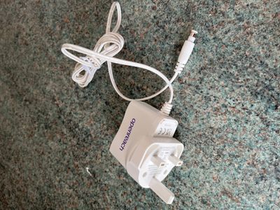

Message posted on 01 May 2026 10:58 AM - last edited: 01 May 2026 11:01 AM
Re: Moving into a new build - ONT Box not connected correctly?
@tommomate wrote:
I thougtht the ONT box was meant to have 3 cables into it?
You need to find the power supply plug.
This or something similar.
