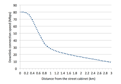

@dougie first point partial fibre uses the copper phone cable to carry the Broadband VDSL dignal from the exchange to the property. Th fibre part is from the cabinet to the exchange. The speed a copper cable can support is mainly set by its length and it is possible but unlikely that the two flats are connected to different cabinets. It is possible but unlikely the lower flat is using the ancient ADSL broadband and there is no capacity for another line for VDSL.

@dougie the link I gave you givesca lot of detail which shouldcexplain exactly why. By the by if it a linitstion on slots at the cabinet while you msy think your move will free one up so allowing a new connection thingsxdonrcwork like that unfortunately.
