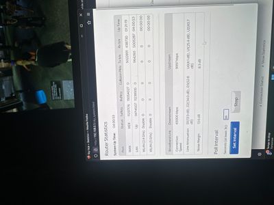

Message posted on 17 Nov 2025 08:47 AM
Re: Line Instability Causing Disconnects - Need Urgent Help
this is from Thursday night when I was experiencing the same issue.
the 2nd picture was taken 15 min after the drop when the line stabilised somehow. But then 5-10mon again internet dropped.
Message posted on 17 Nov 2025 08:51 AM - last edited: 17 Nov 2025 09:41 AM
@Laurentiu+Eduard Noise margin is off the scale, you need an OR Engineer to fix that! Also looks like you are on a 40/10 split if that is correct, but you know what you have as a package, the BTW will say what you can get! Just use the address checker!

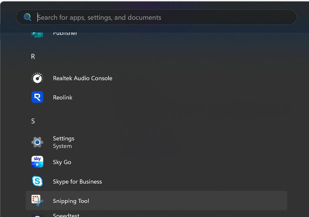

@Laurentiu+Eduard Did you know you can use snipping tool on a Windows PC to take a image of the results rather than a photo of your laptop with the result page?
Message posted on 17 Nov 2025 09:18 AM
Thanks for the advice. I was sending them photos to chat got to be honest trying to see what help can I get.

@Laurentiu+Eduard (& @JimM1_) the two stats are interesting the top one shows a high noise margin of 13dB but speeds are at the max the second set shows a more normal noise margin of 6.7dB with speeds again at 40/10. This implies two things firstly the fault is intermittent noise on the line which can be an absolute pain to sort.Secondly theoretically your line could support higher speeds when operating normally but you have been provisioned onto 40/10 rather than the normal 80/20 profile. Sky will do this where the handback speed is under 50Mb/s.
Looking st the noise issue you said you had used the test port and still hade the issue which tends to rule out the source of the noise being in your home but check if an electrical device could be causing the problem. In the past powerline network adapters plugged in near the hub can be an issue but the list of possible causes is endless. If you can rule out causes in your home then speak to your neighbours to see if they have similar issues if they do dncourage them to raise it with their ISPs. Openreach are very reluctant to do much if anything to sort issues on partial fibre lines especially intermittent noise issues which are very difficult to tracecunless the noise happens while the engineers are running tests.

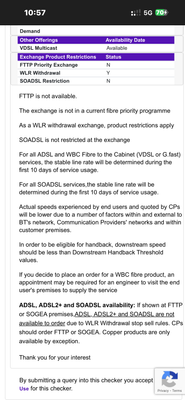

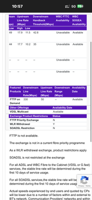

If you would like to know more about why you are on the 40/10 line profile run the following checker for your address and post the results as a screen shot ideally after obscuring the reference to your address Openreach Checker
Message posted on 17 Nov 2025 11:04 AM
This is that came up after doing that check. The router itself it's isolated from any other extension leads, or consoles, laptop etc. it's in an open space. Also later today when I get home I can upload the screenshots from the Sky hub logs(photos from last night) if this will help. I've read that OR are a pain to deal with when it comes to this type of connection in order to fix it.
Message posted on 17 Nov 2025 11:37 AM
@Laurentiu+Eduard the handback speed of 42Mb/s is the reason why you have been provisioned on the 40/10 profile. It looks like you are on a pretty long copper line from the cabinet which is unfortunately always going to be liable to picking up noise especially if running overhead. Openreach used to have specialist teams dealing with noise issues but given the limited life of the copper network these appear to have been disbanded. However keep reporting the fault in the hope an engineer strikes lucky.
