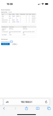

Can you please post your router stats along with a speedtest taken on an affected device.

Hiya James
I have done what you have advised but it does not give me a prompt of adding a user name or password - this is all it brings up

Can you not click 'Maintenance' at the top of the page?

Message posted on 18 Jan 2024 03:44 PM
Re: Issues with Wi fi connection
Your stats show a good line with no hub issues that I can see. It also shows that you do not have any wired devices so its weird that it is showing some of your devices as wired in the My Sky app but I wouldnt worry too much about that as it can be dodgy.
